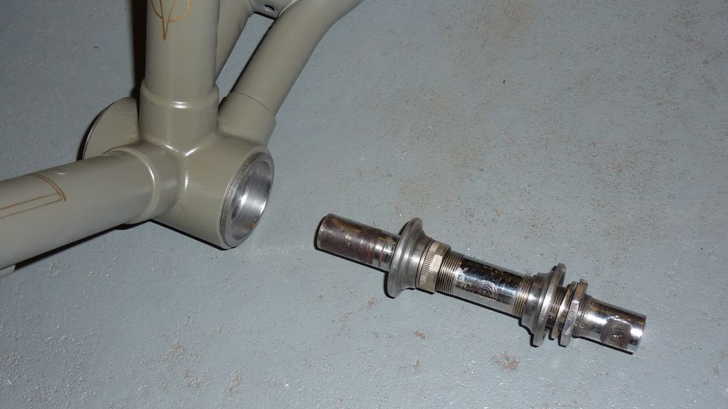

Another example can be seen on the picture below, which is from my 1962 Sport Luxe.
This is a Reich replacement shaft like I mentioned in my previous reply.
