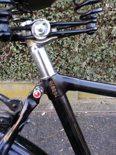

I have verified the frame number and I send you a new picture
There is no hidden number under the paint.

okay Eric,
the frame looks repainted, I believe from the picture, it is power coated. A new transfer (from approx. later then 1959) is used.
There could have been a '1' in front of your serial number.
By sanding and repainting this could have goe easily.
BUT ... the luggage carrier mounting system is defenitely no later then 1956. So, based on that I would assume that the frame is Autumm 1951.
BUT ... as far as I can see, all other parts do not belong to a 1951 model. They are all from the sixtees.
- handlebar
- transfer
- headset and logo
- fenders
- brake rods
- cranks and pedals
To me this looks like a restauration project with a 1951 frame and parts from a 1960 bike.
Don't let this disapoint you.
If you like the bike ad you love drinig it, then it does what it has to do.
Good luck.
Regards,
Ed.

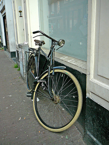

Re: gazelle kruisframe 1950 ?
this could be the original model ?
I found this picture on the internet and I would like to know if this could be the original type of the bike.
the green gazelle x frame is a repainted bike.
I have been in contact with the seller of the Green x frame.
the black also seems to be repainted and gebiest?
looks like fun from further

I just took the picture of the green bike as example to see if it was the same model than mine.
As asterduc told me it is a short bike, I measured the frame this week end. The size is not 60cm but 57 cms.

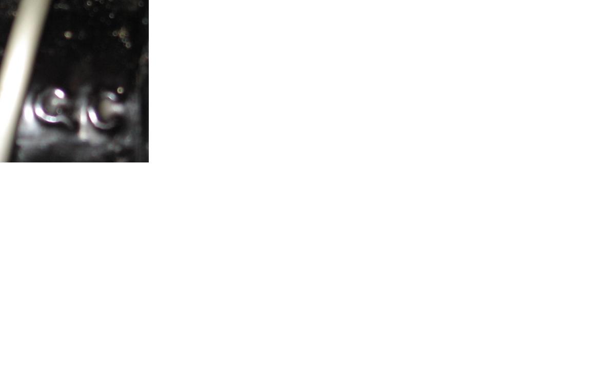

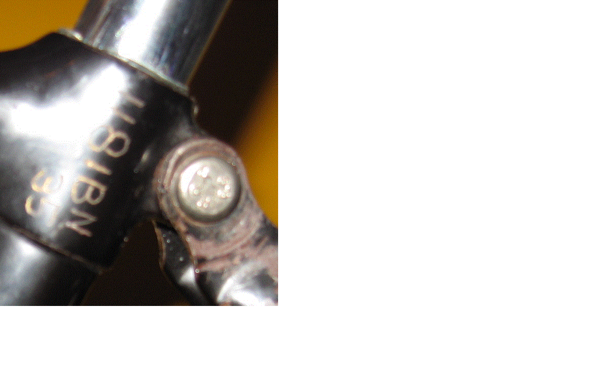

I found also two inscriptions on the frame the first is on the left size of the frame 1181BN35
and the second is Under the frame, Under the pedal box Two letter "GC"
- undertheframe.png (175.42 KiB) 9663 keer bekeken
- left side
- left.gif (141.99 KiB) 9664 keer bekeken
