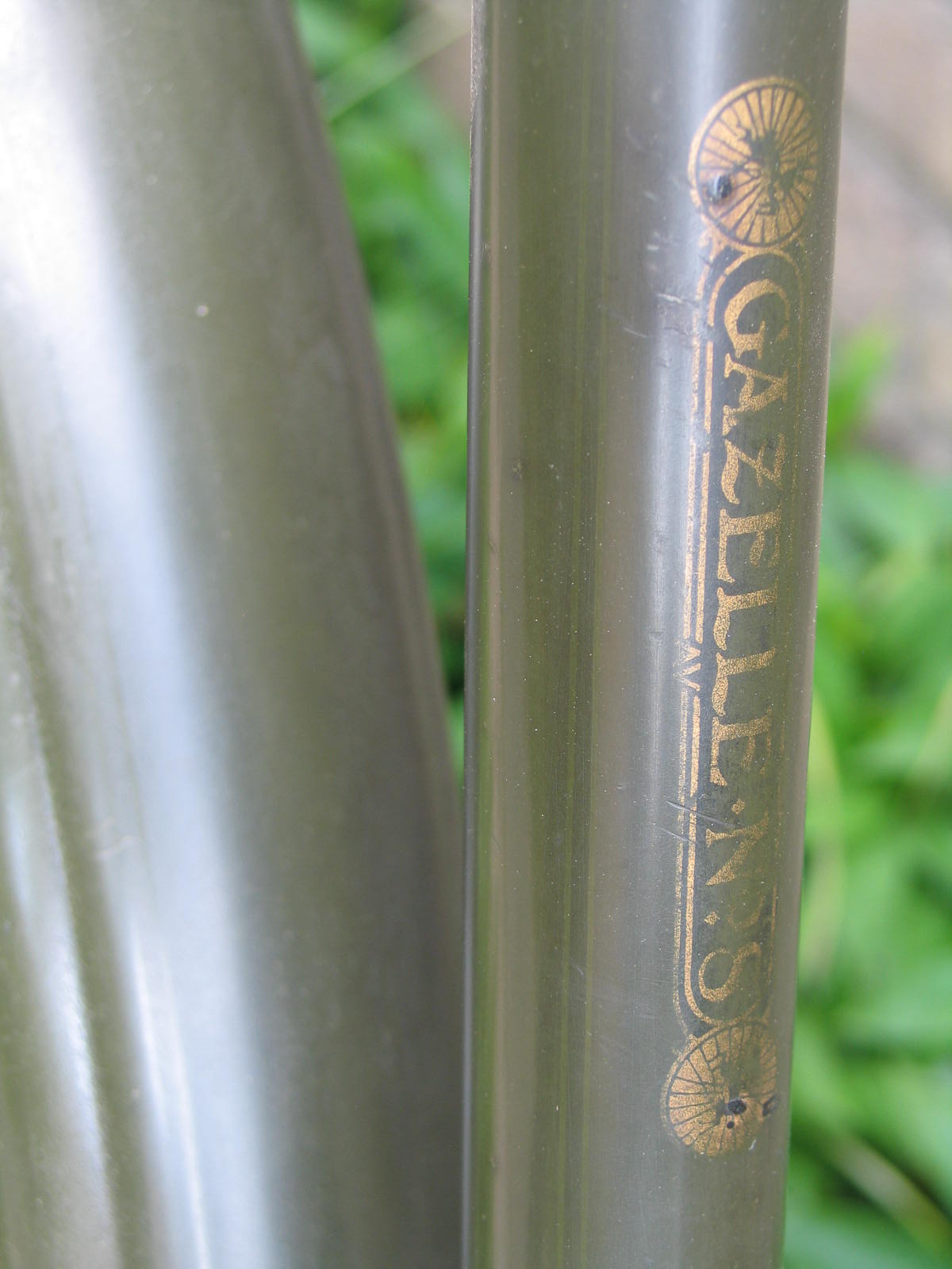

well its a bit confusing you start a new thread every 2 days. Someone gave you a link to Maarten Waarle's nr 7 from 1931, wasn't it?
This should show the decals.
Here is a seat tube decal on my 1939 nr. 8. No other decals attached.
But maybe 1931 still had the down tube decal GAZELLE on it.

- IMG_1229.JPG (158.23 KiB) 10549 keer bekeken

These isn't much to tell what model mine is. I believe it's NOT a number 7 or 8 . Currently trying to join oudefiets so I can take a look at the databank. I guess there was just a basic model.
