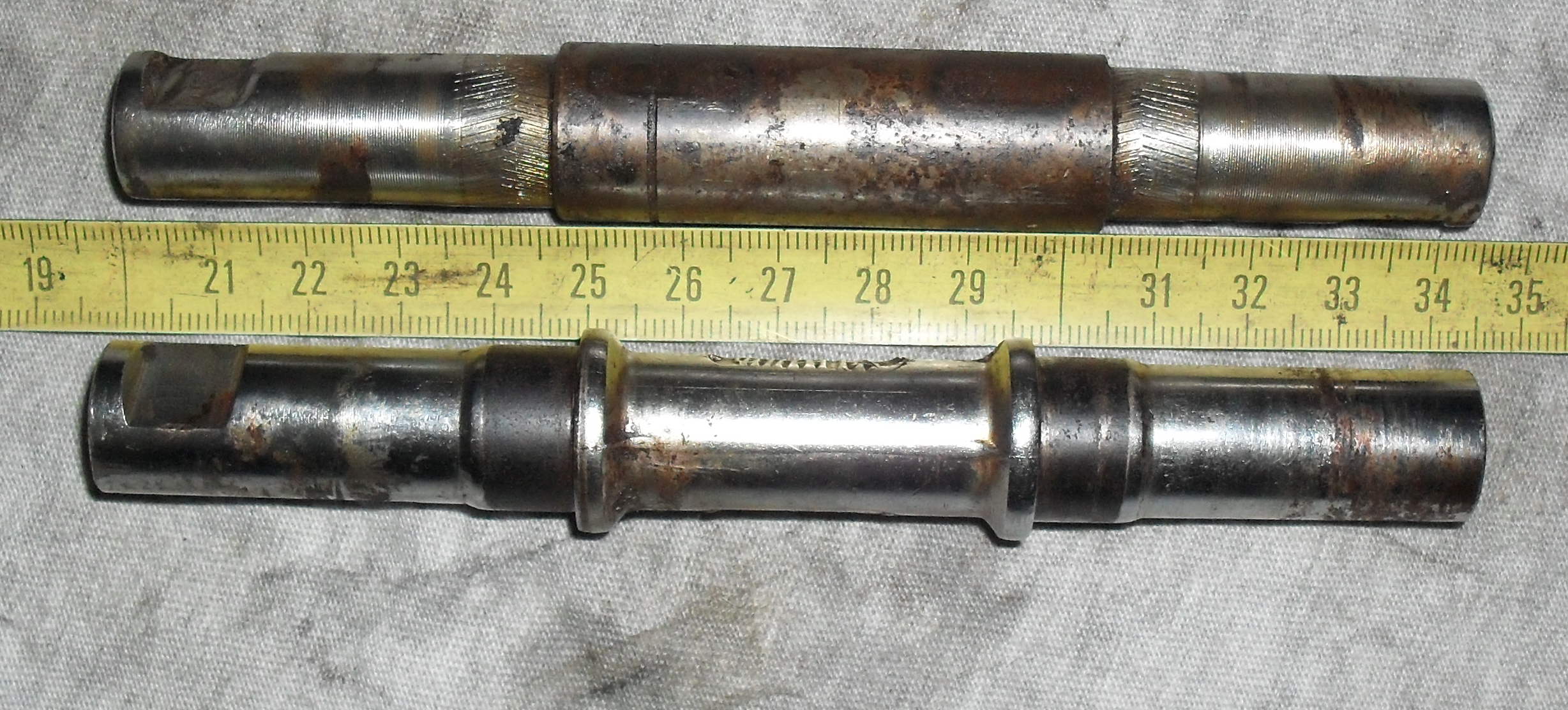

Re: Gazelle Sport Luxe '67 bracket as gebroken, onderdelen?
Hello again,
a quick look in the home-workshop delivered these 2 axles. If you need extra measurements, let me know.
grts Anton.
grts Anton.
